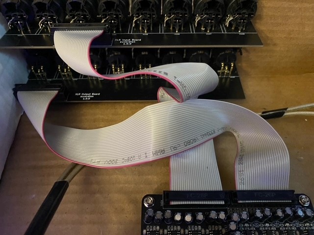

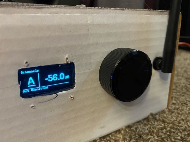

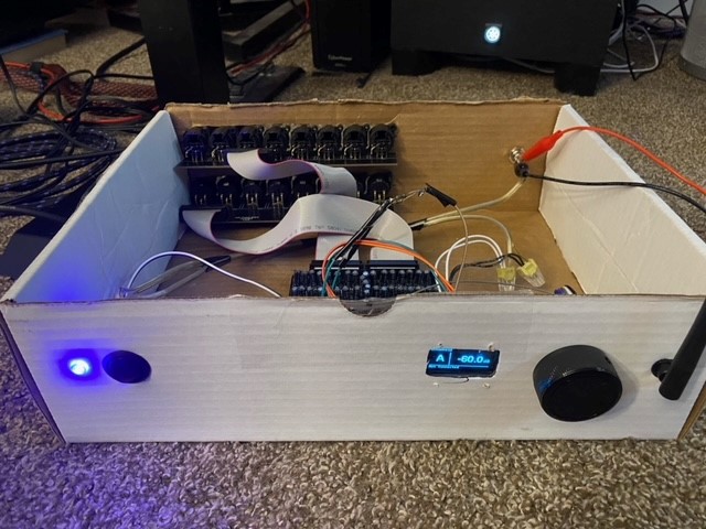

    Apologies as I do not speak German, rather than try to translate myself I will write in English and hope someone can understand me here. I purchased an Aurora DSP board in September and the XLR IO add-on.
    I have completed wiring up power, and many accessories but I cannot get any sound out of the
    unit. I am hoping for some help!
    I have some pictures to show
    my setup in case it is helpful. I am mostly a software engineer, so feel free to laugh at my wiring and prototype case made of cardboard (I am hoping to get everything working and putting in a fancy custom case soon!)

    Everything boots up, the LCD works, the Wi-fi works, the rotary
    encoder works.

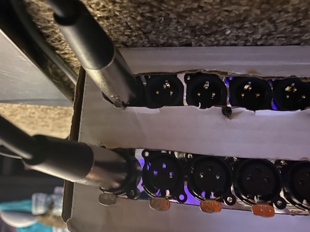

    In case it is helpful here is my wiring.

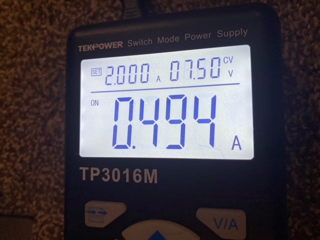

    Here is my power supply configuration showing power draw in Amps while the unit is powered on.

    Check wiring. Maybe you mixed up input/output or direction (red marker).

    Double triple checked. The output and input boards are connected per the manual and for kicks I tried swapping them with no effect. The ribbon cables have a tab on them so they only fit in one way on both ends.

    Is there no sound on all channels or only on one channel?
    You can also remove the AddOn connections and connect input and output cable directly to the IDCs on the aurora board for a check. Please refer to manual for pin out.
    You said something with white noise fading in and out. I saw that on a board where the customer has grounded the cold output of the DAC output and did run it in this configuration for a while. This damaged the opamp.
    If you cannot find anything, you can return the boards for a check.
    All channels seem to be out of commission.
    I think that sending back for a check is a good idea. It is very possible that I may have hurt the board, Im not very skilled at the electronics part of all this.
